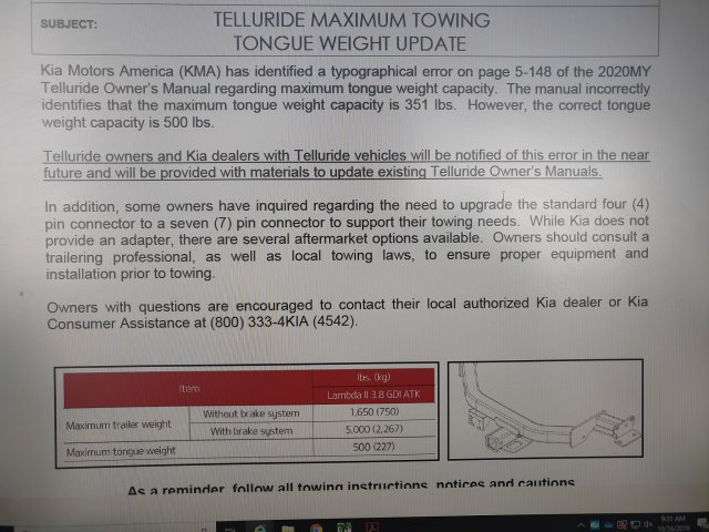

FYI, Kia corporate decided to up the tongue weight from 351 to 500 pounds on the Telluride, so it stands to reason that we should see a similar update from Hyundai corporate on updating the manual for the Palisade to mirror this as well. This would open up towing for all of us that have trailers in the 3000-4000lb range...

I hope this is further evidence that installing a 7-pin will not void the warranty. I'm finally pulling the trigger and getting the Curt 13427 installed in a couple of weeks. The tow-hitch plus labor to convert to 7-pin was quoted at $679 plus tax.

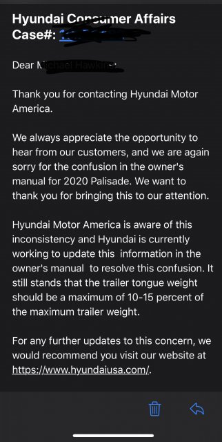

More good news on the tongue weight update: Received an email from Hyundai corporate, and they are aware of the confusion and are working to update the manual. They are stating that you can tow 10-15% of your trailer tongue weight when towing, see email below:
