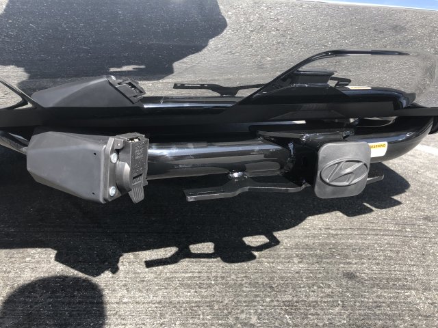

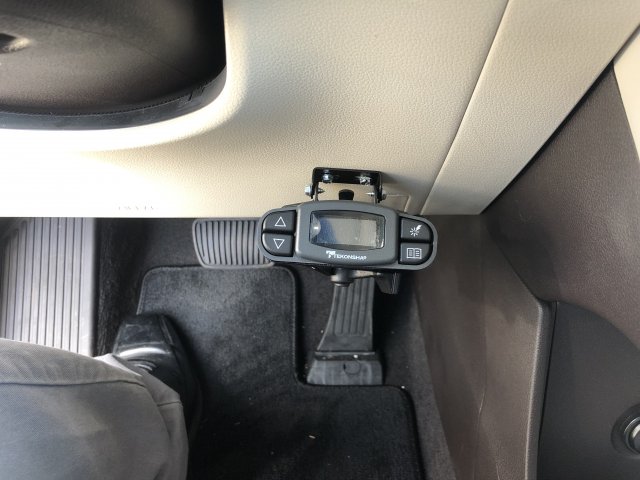

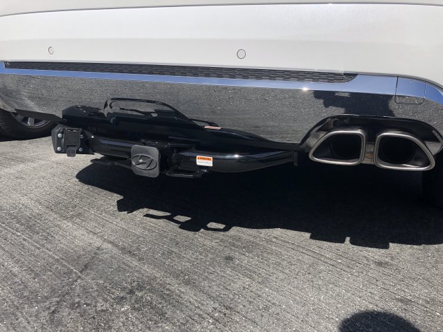

OK so finished having the install done at the trailer shop. Had them install the following:
  • Palisade factory tow hitch
  • Factory 4-pin wiring harness
  • P3 Tekonsha brake controller
  • Dedicated power and brake controller line from cabin/battery to 7-pin adaptor
  • 7-pin adaptor that they had in stock that mounted right to the factory tow hitch
A nice touch is the tow hitch includes a Hyundai-logo branded cover. Here are the pics:

View attachment 723 View attachment 724 View attachment 725 View attachment 726 View attachment 727
Wow that’s a really clean install of the 7-pin and brake controller.

#28

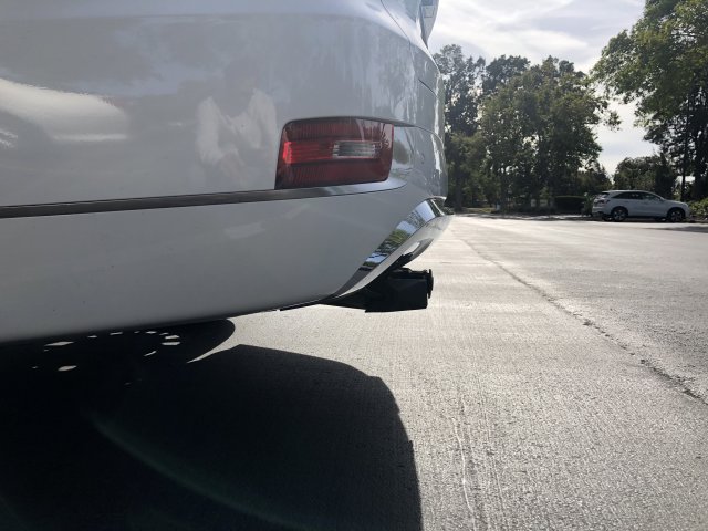

@Mikeg112 can you measure how much clearance there are to to the bottom of the hitch? We have a steep driveway I think it'll scrape. Also thanks for the photos.
Just wish it was more integrated into the bumper like the Telluride.
50
41
#29
Thanks for the photos @Mikeg112. How much did the shop charge to install the hitch and wiring?
Sure, it was $100 to install the hitch, and $250 for the 7-pin wiring. They ended up having to run a separate line from the battery to the hitch, this allows me to be able to power the electric brakes and charge the battery on the travel trailer. A 4-pin connector only had a 4-5 amp max so it takes that load completely off the left-right turn signal lights.

#30
Here are the measurements on my flat driveway:
  1. Floor to bottom of hitch: 10 inches
  2. Floor to top of hitch tube: 12 1/3 inches
I ended up watching this video on hitch rise/drop, and here are my calculations, let me know if this seems right:
  • Bottom of trailer ball hitch mount from floor: 20.5 inches
  • Floor to top of hitch tube: 12 1/3 inches
  • Difference: +8.2 inches or an 8" rise
Next plan is to order an 8" riser, hoping that makes sense.

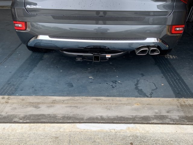

#34

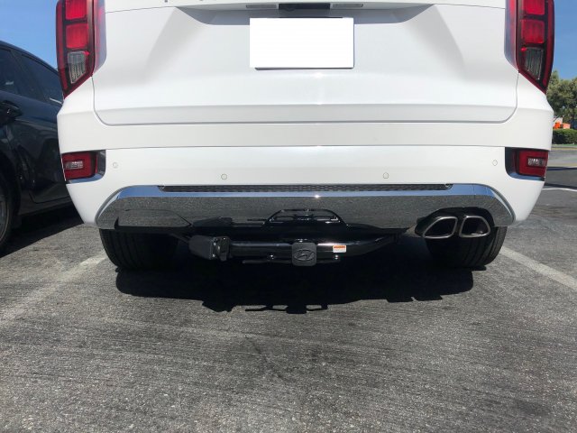

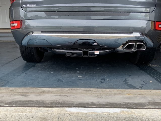

Just got mine installed. Here are some pics. Does not stick out past the bumper. E27EF5E7-8565-4309-B4D6-3E592E0A068B.jpeg 7D121CDF-209F-44D7-9C9D-1A2B9D27514F.jpeg

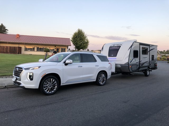

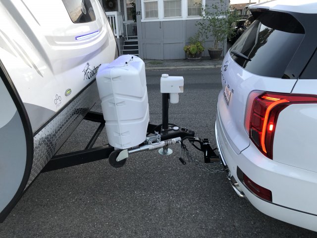

#36
EB67DB02-AD45-41AF-842B-6A40216A43A7.jpeg 71EF6F22-1BF0-4485-948E-9C937D7AA303.jpeg 6711E375-E2B2-4681-A1B7-6CD8601F9276.jpeg
After renting a truck for past six months so happy to finally have a tow vehicle that can handle our 4,000 trailer. Took it for a brief test drive last night, here’s my initial feedback:
The palisade did sag a bit initially once you hitch up. But the self-leveling takes about 3-4 miles to adjust due to the nature of the self-leveling shocks. I probably have about a 1-inch drop in the rear axle, will drive an hour to our camping spot and see if I need a weight distribution/sway control hitch over the weekend.
Drive: as a driver you do notice you’re towing, but leaving in comfort mode it almost auto-adjusts the rpms to match the uphill and towing. Surprisingly my wife in the passenger seat didn’t even notice that we were towing! I tried sport mode but was revving a little too high for my preference, so I leave in smart mode for now.
