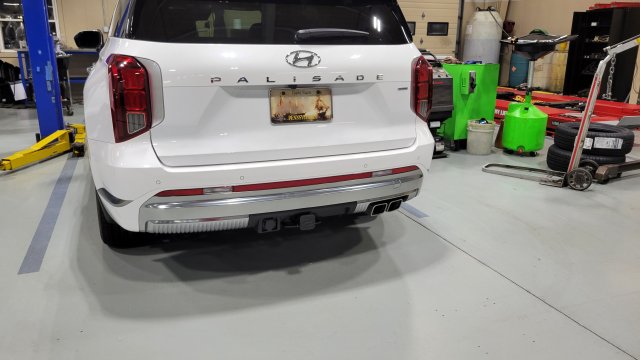

Got my hitch and harness for my 2024 Calligraphy. The only disappointment is the center section that gets replaced is black instead of the silver like the rest of the trim.

Yes, I got it. It is a Hyundai hitch and Hyundai wiring harness. I’m a Hyundai dealer in Pennsylvania. Here are the numbers you need Hitch for the 2023 - 2024 Calligraphy is S8F61-AU300, the harness is S8F67-AC700

No concerns at all. It took about 2.5 hours to install everything in a shop setting at home would be slower, but could be done. All wiring was plug and play, and all lights function normally. Also, I work in a Hyundai dealership, so I was checking every day and placed the order the day they became available.

Sorry, I haven’t been on here for some time. The center section is held on with clips and screws from the back. The new wiring harness is a 7 prong. I bought an adapter on Amazon for $10. so I can use 4 or 5 prong plugs. Glad I could help.

Unfortunately, I have good news and bad news. The good news is that it didn't take Hyundai too long to get the hitch after I gave them the part numbers you provided. The bad news is that it cost $800 -- ouch!
More good news is that the installation took the amount of time they estimated. The bad news is that it took 3 hours and cost $550 -- ouch, again!
So, for $1,355 I have my new hitch. Woohoo!
The final bad news is that the fit and finish is not even close to what I expected -- and certainly not up to Hyundai's normal standards. Specifically, the hitch does not fit properly on either end and is much worse on the passenger side, exposing the undercarriage and the slots that the panel that the hitch replaced went into.
I went to the dealer to complain and the service manager told me that the mechanic installed it properly and there was nothing they could do. When I wouldn't accept this, he sent me to his boss (the "Fixed Operations Director"), who basically said the same thing. The way we left it is that he suggested I contact Hyundai directly at 800-633-5151. Before doing that, I wanted to check with you to see if you had a similar experience. From the pictures you provided, it looks like your hitch fits perfectly. I've attached some pictures showing the left and right side of the hitch before and after installation as well as what it looked like prior to the installation!
What's annoying is that the plate they removed to install the hitch fit absolutely perfectly. It's hard for me to believe that Hyundai was that lax when designing and manufacturing the new hitch.
Finally, what's really annoying is that my 2017 Explorer has a decorative plate which covers the hitch so well when not in use that you're not even aware that the vehicle even has a trailer hitch!
Sorry for the long post, but I'm really irritated that I spent that much money for a shoddy product and/or workmanship and the dealer doesn't seem inclined to try to make it right! :-(

Hi Steve, mine has a similar gap between the bumper and the black trim. Unfortunately this is what Hyundai gave us. I wish the trim was silver and fit better also. Something looks odd on the right side, I wonder if they installed all the clips and bolts correctly. But give the fact aftermarket hitches are even worse, I’ve learned to accept these couple short comings. My dealership charges 3 hours at $142.00 / hr. to install the hitch and wiring harness. I think your price is probably correct. Hopefully everything else about your Palisade will make up for the hitch issue. I’m glad I could be helpful. -Mike
